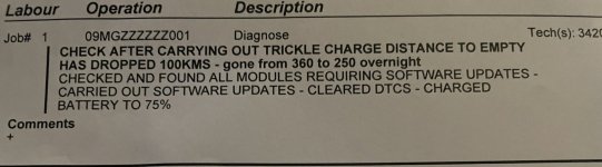

It wasn’t the battery and it also turns out it had nothing to do with the temperature.
I just had it put in today and all sorted at MG service under warranty.
Diagnosis : There was a bunch of modules that required software updates. I’m now getting 30km more on a full charge than when I first bought it. It has been cold down here getting down to 4°C a couple of times at night. But that had nothing to do with it. It’s 8 1/2 hours for them to figure it out and charge it to 75% just to make sure.
So people if you haven’t taken your car in for a service and have lost significant distance chances it’s this. I posted a copy from the MG service showing the description.
Good luck.

PS when you book your car in make sure your cars first car going in to the service shop, and show them about these updates, also make sure you get a loan car. Because it’s going to take all day.
