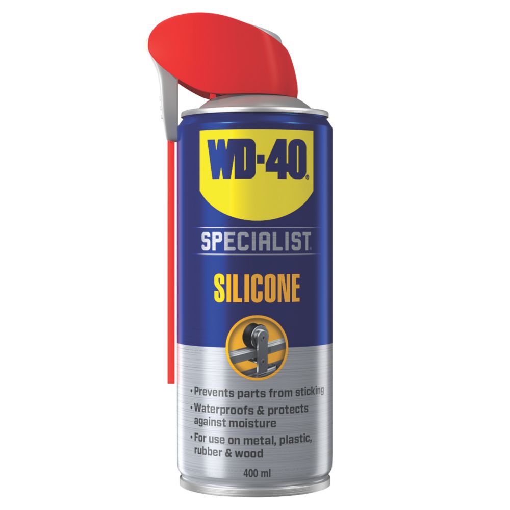

Could I ask If you have link to the silicon spray you use? I have an annoying rattle that appears to come from centre of the dashboard near windscreen On my TCLR.
TIA.
TIA.
No problem !.
Any type of silicone spray with be okay, but I used one of the tried and tested WD40 range of products.
I also use there white lithium grease spray for lubricating the door locks / hinges / door check straps etc etc.

If you use an old plastic locality / bank card, you can slip it behind the gasket.
Pry the plastic card back and then insert the nozzle of your spray can.
Apply the spray and move the plastic card across the windscreen bit by bit, spraying as you go.
If you have a set of the plastic trim removal tools, you can use one of these to pry back the gasket slightly.
Removing the fasteners will give you more room of course.
From memory there is only about five screws to remove.
I think I removed the soft long rubber bonnet seal, that runs across the scuttle panel, you can see in the photo.
If you just pull up the seal, starting from one side, it will easily come away and it is easy to refit later.
With all of the screws removed you will have plenty of room, but you will not be able to remove the scuttle panel completely from the car, unless you remove the windscreen wiper arms as well.
Silicone spray is great if you do not want to remove the screws etc.
You can use some silicone grease on the gasket if you do decide to remove the screws.
In both cases avoid getting silicone spray or grease onto to the wiper blades, as it will smear across the glass and is hard work to remove when this happens.
If you do get a small amount of silicone on the very bottom of the glass, then use some kitchen towel and something like methylated sprits / IPA to remove it when the scuttle panel is back in place.
