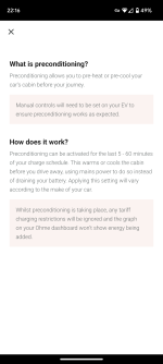

If anyone got ohme home charger there is option for preconditioning which will automatically give power for a preset time before your scheduled departure time.
