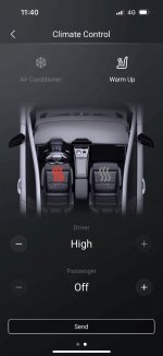

Just an FYI, if you’re preheating the seats or using the app to control them, they are the wrong way round 🙈🙈🙈 if you preheat the drivers side, it heats the passenger and vice versa. 🙈🙈🙈
Just something to be aware of when the colder months come and you think you’re getting your seat cosy and warm! ;)
I’m UK based and my car is RHD, it just seems the app is set up for LHD!

Yes, I tested this this morning. In the screenshot posted by johnnyc, what matters is the position of the seats. So turning on the right hand seat turns on the driver's seat in the UK. just ignore the word 'driver' in the display.

Hi im looking for the seat preheat function on the app and can't find it whee did you find ?
Splodgie does the first picture not show it within climate control on the app. As the guru states model dependent.
First you need to turn on AC using the slider at the bottom of the screen and entering your pin. Once activated you get to the screen shown above by pressing the newly appeared blue HVAC icon on the top right. If you still can't find it, let me know and I'll try to get a screenshot

Then you have to swipe across for the seats.
I've not used the seat pre-heater function yet, but just to clarify then, if I want to heat my seat (driver's) I select the passenger one in the app ?
Yes. MG have got the seats mixed up.
