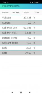

I bought this one off Amazon which was mentioned earlier in the thread. It did give a strange reading for max cell voltage, mind.
Definitely a reading error there in you max cell voltage of 60.986.... if only out battery cell did have that that much capacity.

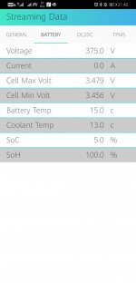

Ran battery right down until it shutdown Was 5.0% on the App and 375 total volts. My max is 97.0% at 456-7Volts. Will take screenshot when charged fully. Usable 92%.
I doubt MG have reduced lower buffer from 5% to 2%
... I think someone (Jody) had 3% & 94% (93.8%) giving usable 91%. So I suspect 1% is to hide the first year degradation.
