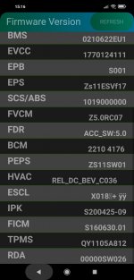

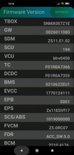

Oh, did you get the obd2 versions before and after the update then, interesting to know what they were/are. So they were the only 2 modules updated to provide the comfort pack 2?

No they didn't, and in fact I specifically requested the Comfort 2, it was not offered as part of the service (paid or otherwise), I think that the dealer may be managing resource though given Covid as they are generally pro-active in what they offer. Unfortunately I Didn't get the readings prior to the year 1 service and update to Comfort 2

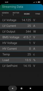

Well most electric cars show State of Charge % but this is not included on the MG ZS EV and this is what every owner has been after since 2019. This is a free 3rd part Android only app that gathers the data from the car via OBDII adaptor so we can see battery % / State of Health and lots of other data we have previously not had access to on the car.

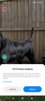

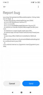

Hi. Newbie here!

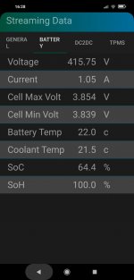

Had my OBD device delivered today. After a bit of fiddling I managed to get things working and had some readings but quickly it crashed with the attached error messages. Any ideas? Thanks.
