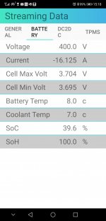

Just a note about battery voltage. Unless the car is at 100% state of charge with no load on at all they are meaningless. The only figures you can use to compare are when it is at 100%.
Strange as the car has finished charging and had also equalised so not sure why its showing 93%
The difference is the top buffer
So it's normal, nothing to worry about if 93-4% on the new update. Prior to that about 96-7%
This ties in with what the OVMS guys were thinking plus what @MilesperkWh also said a while back.

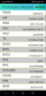

First reading and OBDII device used; will upload data with 100% charge later in the week. Bought car end of December 2020, driven 500 miles, never used rapid charger, only used fast 7 KWH charger. BMS update on 25/01/2021.Done only one equalisation since, got 449V. How data compare with other cars of the similar age and mileage?

As I mentioned above the data is pretty meaningless if you are not at 100% SoC as that is the only figure we can use to compare.
Currently have the car on charge, should be done in a few hours (Long Equalisation BMS) I'll do another data dump when it's done :)
Thanks Mike, will come back with figures with 100% SoC.
Originally we were all focused on identifying the software versions, which is the data we were collecting.
Now looking at & collecting the SoC % data, we do indeed need it from cars that are definitely 100% charged & balanced and when the car is not under any load (don't depress brake pedal when turning on)
Added to the spreadsheet thanks.
Is yours Exclusive or Excite model?
Can you see if you can get a better reading for the HVAC firmware version? For some reason (I assume depends on the obd2 dongle) some items aren't always complete properly.

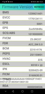

My device arrived a few minutes ago.
Read the firmware.
Currently have around 50% charge which is consistent with the GOM and the bar display.
Car (excite) registered August 2020. Has 15 jan BMS but had the duff one for a few weeks.

Oh darn, that blows the A-C HVAC with the excite/exclusive idea out the window
Oh no you're right!
What on earth is that about then, we'll have to ask the person who had the B version to rack their brains about what could be different.
