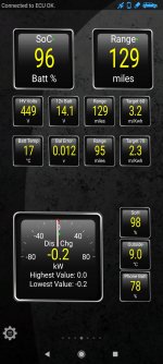

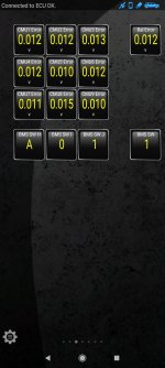

Looks like the torque pro readings just give the cell error figures. Not sure if this is any good for diagnosing the issue?
