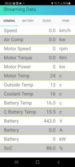

I got curious about OBD and bought a device. My car has done about 13000 miles just over 12 months but SOH showing 97% ?.
Attaching screen shots , has something gone wrong with battery or is this what is expected ? , it was initially charged at home with 7 amp then mix of CCS and rapid chargers , lately rapid chargers at work
Yes, all EV batteries have degradation. Usually, the degradation is worst in the first year or two, then levels off. To prevent panic, MG report 100% for the first year or so (unless there's an actual fault with the battery). I think that they call the manufactured capacity about 103%, and report any figures over 100% as 100%. That means that cars about a year old are seeing their first real degradation figures, and it can be a shock at first.
Time will tell how good the MG battery, made by CATL, will be long term. They're one of the biggest suppliers, so I think we'll be ok.
