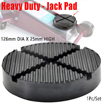

Bricktop X PWR Prominent Member Joined Aug 30, 2023 Messages 1,375 Reaction score 2,905 Points 764 Age 57 Location West Wales Driving MG4 XPOWER Mar 29, 2024 #2 GrayCat said: Please tell me, what are the proper points to lift the car? The blue ones, or the green? Click to expand... I've had mine up a few times and lifted on the sill seam (blue) Could be a risk of slippage on your other choice. I use a 3 Tonne Jack with a large rubber pad for safety and security.
