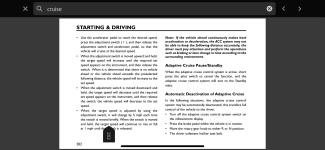

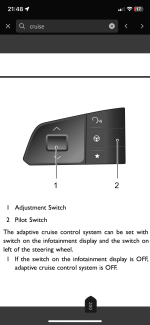

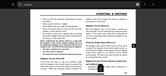

Page 202 of the manual:
“Adaptive Cruise Pause/Standby When the adaptive cruise control system is active, short press the pilot switch to cancel the function, and the adaptive cruise control system will exit to the Standby state.”
