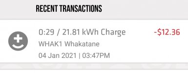

I'm in New Zealand. I've had my eZS since November 14th. At first, the range was just as I would have expected. I went for a long drive the day after getting the car It easily did 193km before the battery low light appeared. Awesome.
But the range has gradually been declining. Day to day, I don't really notice as I live in a small town and might only drive 10km.
But when I attempt longer trips I find my range to flat is now, effectively, about 150km. Last week, I drove 670km to Wellington and returned the next day. I wasnt able to drive more than 100km without getting the low battery warning. Sometimes even less. When I charged, from 6% to 96% (in one example) the car only gained 23kWh. That means my max charge seems to now be 26-27kWh..... The same as my 2016 30kWh LEAF.
I seem to have lost access to about 15kWh......
I have the warranty process underway - awkward at Xmas / NY - and will be taking the car back to dealer next week for them to have a look. This just isn't right. The attached image was a charge yesterday from 12% to 100%..... Only gaining 21.8kWh.

That sounds like there may be a faulty cell in the pack that is limiting access to the full pack capacity, I’ve not seen this before in MGs but (as a former Leaf owner myself) have seen this kind of behaviour on older 24 and 30kWh Leaf packs.
Hope MG NZ get you sorted soon, and please keep us update, always worth pooling issue knowledge so other users can self troubleshoot.
Agreed. It looks like a faulty cell. The limit seems to be 27kWh. There is also some discussion on Facebook that the battery heating update broke the BMS and this 27kWh 'limit' is a consequence of that. Hopefully they will just be able to remove that update........and we can test it from there.
