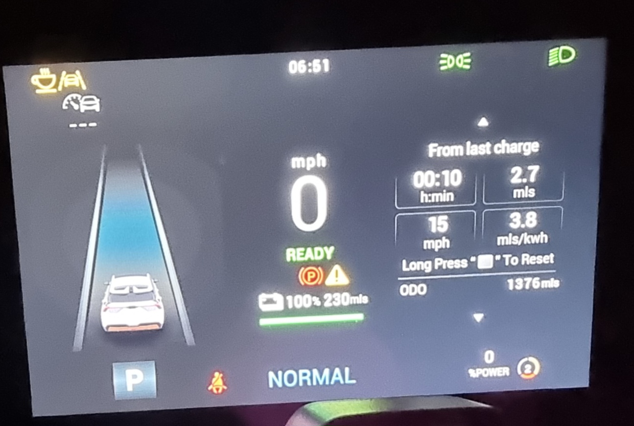

Full charge this morning on a MG4 SE SR after 476 miles mixture of local, rural and motorway driving. Temp at 22C fan on auto and driven in normal with regen 3.
Had the car since 16th Dec, had some updates yesterday and the mi/kWh read out updates more often and appears more optimistic than the big standard 2.0mi/kWh I got previously when setting off.
How did you manage that? What’s the temperature like where you are?
