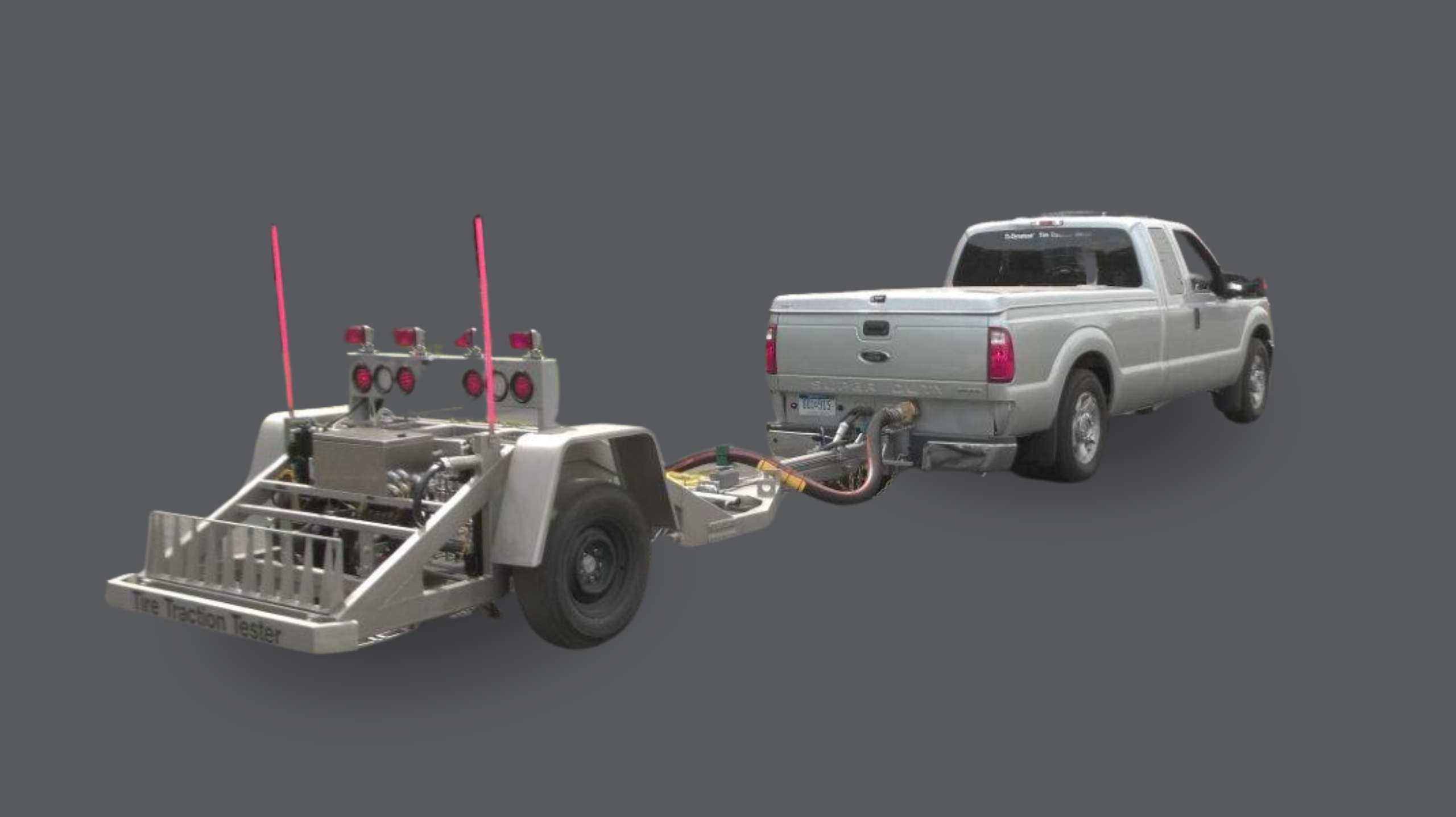

Need to attach one of these to each wheel of the car and see how the traction/friction characteristics change with different regen and acceleration applied
