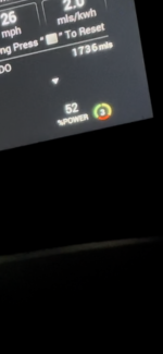

I took delivery on 31st March of a new Trophy. Since then, no regeneration has registered on the charging screen at all. It is set to Normal driving and Strong regen settings. Any ideas what has gone wrong please?

It's working then. Not sure where it shows up on the MG4 but my MG5 has a needle that goes into the blue under regen.
Right hand bottom of the driver screen.
There’s the coloured circle and then a number to the left.
Foot down is 100%
Neutral throttle is 0%
Any ‘throttle on’ figure is white
Regen shows a negative figure and turns green.
