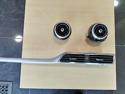

I tried to remove one of the round vents and it won't move. I tried squeezing it top to bottom, side to side etc. and there's no movement at all. :cautious:
That video looks like it's from the petrol MG ZS. Dunno....could there be a difference?
Have a look at this ebay listing for the vents, it shows where the clips are situated, looks like it just slots in and has same retaining clips as the long silver parts.
Those clips look quite hefty, probably needs a trim removal tool to get them started.
I can't get this out, at all. I fear breaking it. Those clips does indeed look hefty.
