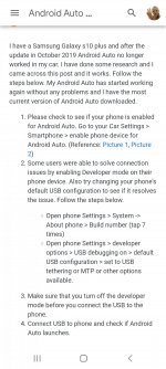

Try the following, I had to do this a while back
Or this
