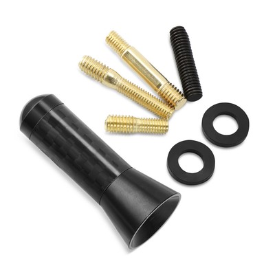

Hi Gandalfharrow, aye when I had my ZS I bought a wee stumpy aerial which was around two and a half inches in length.
We very rarely use a radio in a car so I can’t really vouch for its performance but
it actually looked better than the original to my eye.

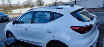

The visible aerial on the roof (particularly the long whippy stick) is for the radio, nothing more, nothing less. You can replace these very easily from as little as a few quid from ebay or amazon or heaven forbid a Motorworld store or Halfords.
It has nothing to do with GPS, 4G or anything else suggested. The "Whip" antennae is literally just for the radio. So go online and find yourself a short replacement like Archev did and all your problems will be solved.

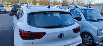

i put that one that has the logo MG, i bought a kit, were two antennas come the shorter one (still not used) with no logo and the longer with MG logo...

I got this and it works just fine

I changed my aerial for a stubby one and it's fine, and car also goes in the garage.
