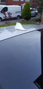

My solution was to fit this sharks fin aerial kit that I got from Amazon. Had to make a couple of adjustments to make it fit properly but it's been there since Christmas and has had no detrimental effect on the radios performance either DAB or FM.
Which one?
