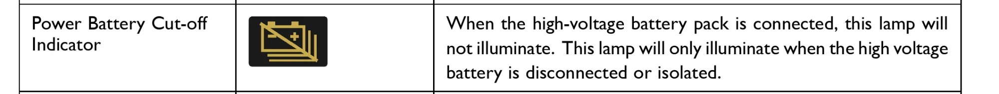

We then drove off, and a minute or so later, an icon that I have never seen before appeared, without the fearsome bingly-bong of the usual alarms. See attached, taken from the manual. It's what looks like a yellow battery, stacked 3-high, with a yellow exclamation mark through it. Nothing else untoward happened. As it happened, we had to stop again a couple of minutes later. I locked the car and there was a small blip of the hooter, almost like when you leave a door open and try to lock,, but shorter than that.
A few minutes after that, we climbed into the car and drove home, absolutely normally.
So the questions. What on earth happened? And should we really contact our dealer about this as the manual suggests? It seems rather drastic. I'd welcome any comments.

I only ever see that light when I finish a DC charge, then when I tap the brake the light goes off. It’s very strange this light would come on whilst driving as it indicates (as far as I can tell) that the drive battery has disconnected. Which would leave you without drive power I would assume.
Personally I would chalk it up to a glitch, but if it happened again I’d be talking to the dealership.
