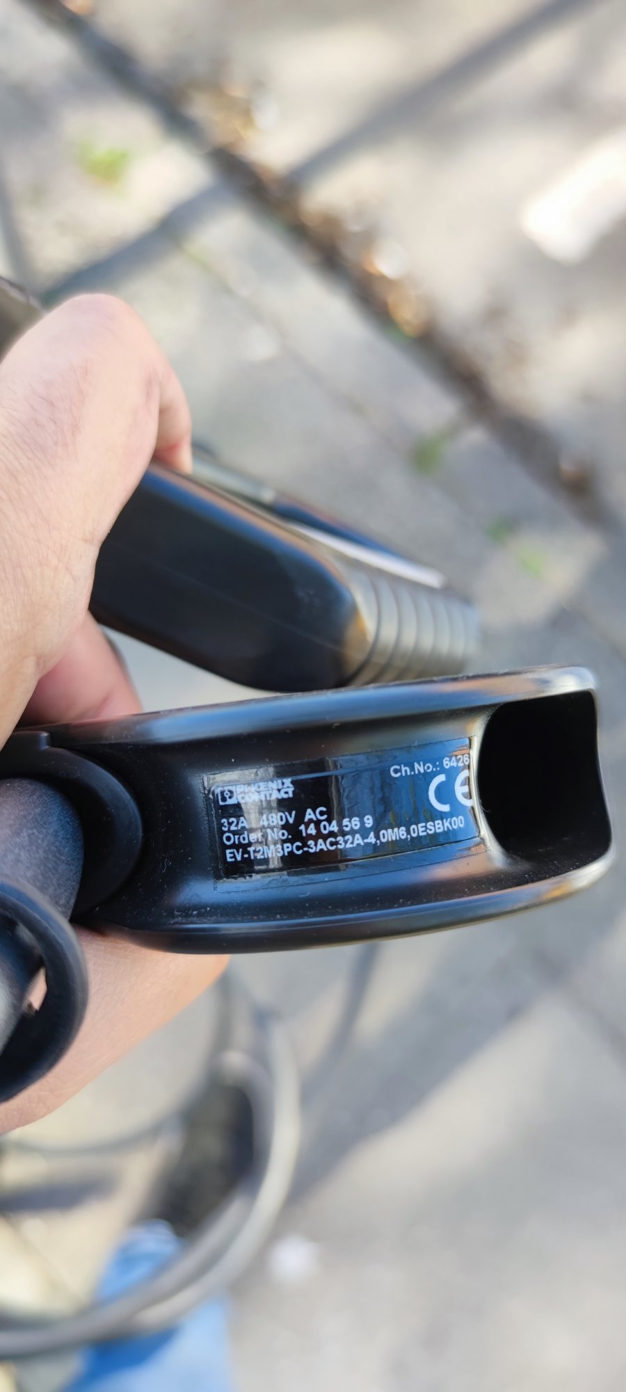

On the your very first set of pictures your plug is stating 220 to 250v. This would suggest the cable is single phase so you would only get around 3kW. Try a three phase cable and it should work ok
@Enucos OK you cable is definitely 1 phase 3g6mm means the Neutral, Earth and L1 are 6mm at 32amp so missing L2 L3 ie you need 5 6mm for 3 phase

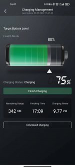

Case closed, it was the cable.
Attached pictures with different cable.
