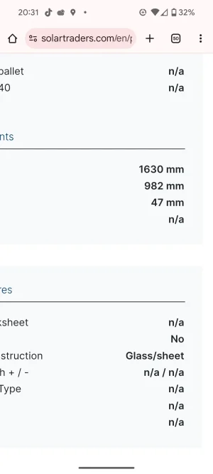

So next step is to get a replacement panel. So if nine is Samsung 247 w and 1.63m Lin and 0.98m wide, any suggestions on a panel and where to get it.
Do you know if this 1.panel.might have caused this drop in amps and the low voltage error in inverter.
