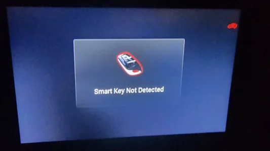

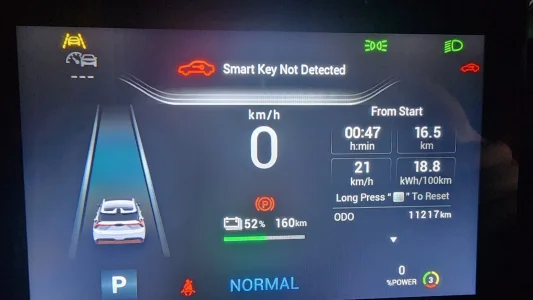

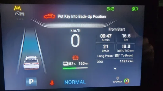

My MG ZS EV 2021 Exclusive - is in a Bodyshop for some minor repairs. It was driving and starting all ok.
However, after the front driver door loom was unplugged. The car wouldn’t start. There are 2 messages on the dash ‘Smart Key Not Detected’ & ‘Put Key In Backup Position’.
I have put the key in the front cup holders as per manual instructions. Still same error.

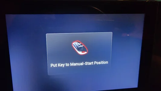

Hello! The same problem here, but with an MG4 EV, the car isn't recognising the smart key, it can open and close with a fob, but the car is bricked and won't start, even though the key fob is in the back up position as per manual. I tried both fobs without success, didn't try to remove the 12V battery yet, the car is showing the following messages:

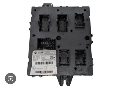

They called me after few days and said that the Body control module (BCM) needs to be replaced, they ordered it, I took my car back today and I will bring it back to install it once it arrives. I will update here if it works.
Yesterday finally after installation of the body control module, a few updates, the car is back to normal ( it took them more than 3 months to fix it, and my infotainment software is still the factory version, they said our region don't get the newer infotainment software update, so if i do not turn off LKA and AEB before every lunch my car can kill me.
The problem started on March 28th, on my MG4 se, I couldn't enter the car by pressing the door knob, so the only way to enter was by normal fob unlock. After sitting the car wouldn't turn on, ( no start/stop button on mg4 but a pressure sensor under the seat like for the seat belts) so another unlock press needed, afterwards a warning sign images attached was showing. In order to turn on my car I had to unlock for the third time then press the brake, only afterwards the car will be ready to start. After driving, the doors locks automatically after a certain speed and the warning beeping comes again for 15 times. Then everything is normal till you turn off the car.
The fix technically by installing a body control module ( the one attached is for the mg4), i was told they configured the key fobs for the new hardware, and then installed some software updates.( Not for the infotainment system in my case).
