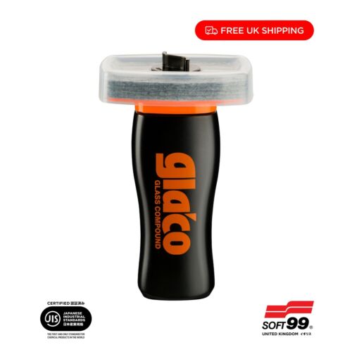

I used this to clean mine, it got rid of grease and water marks. It took a couple of application as my screen was really bad.
"Prepare the glass surface by washing it thoroughly with a pH neutral shampoo and drying it with a towel or microfiber"
Seems a bit of a faff? & That's before you even open your £12 worth!
I guess the prep is to make sure you don't scratch the glass or embed any grit in the applicator which would scratch the glass. I didn't bother with that, I just did a quick spray over with some glass cleaner and paper towel.
I've spent hours and a lot of elbow grease on past cars trying to get residue off windscreens, without success and this is by far the easiest to use and the only one I've used that actually works with the least effort.
