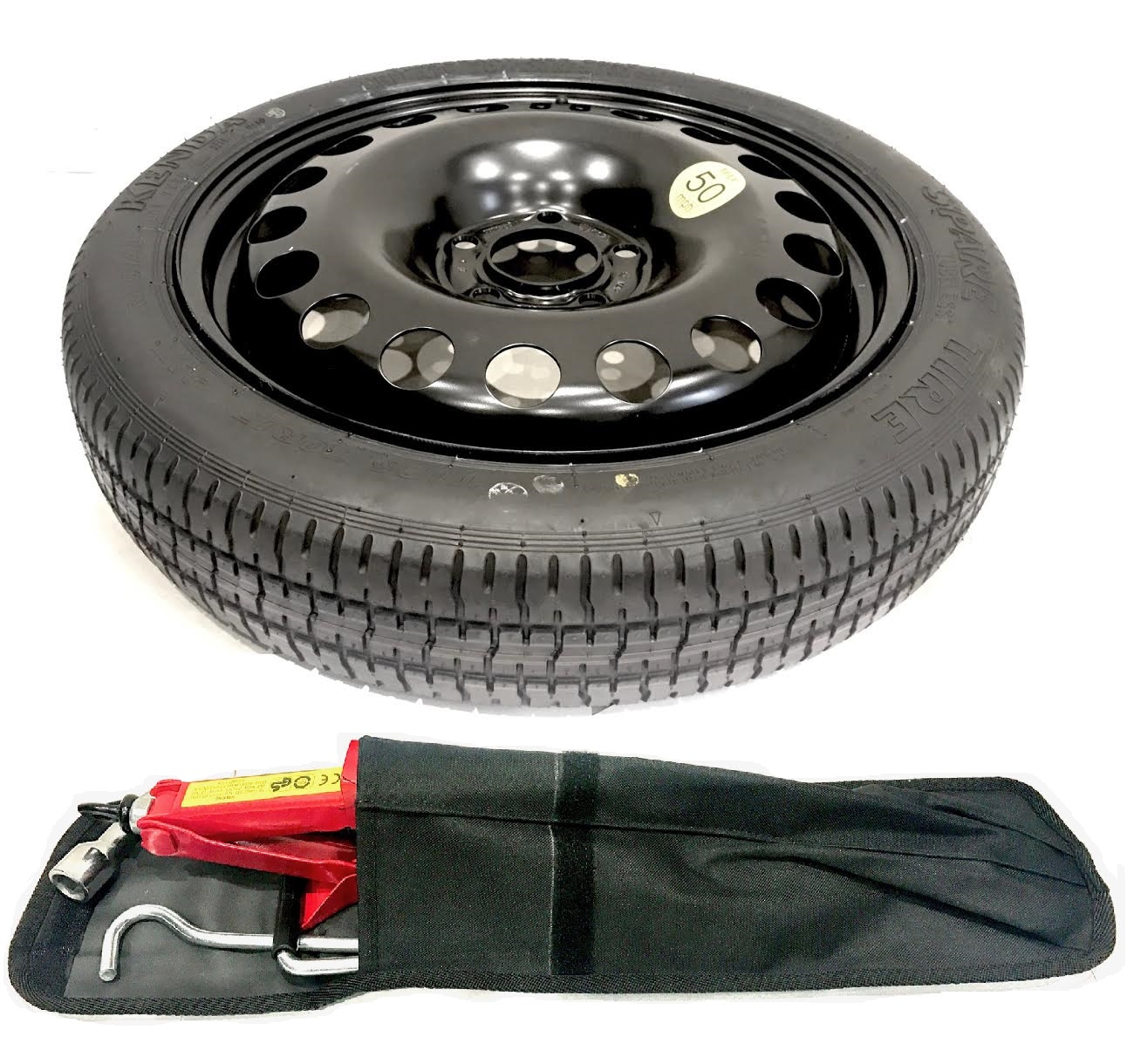

I got this , fits perfectly. The jack fits well in the space vacated by removing the pump and gunk. 16″ SPACE SAVER SPARE WHEEL + TOOL KIT FITS MG ZS EV ELECTRIC (2017-PRESENT DAY) | eBay
I also got a cheap cover for the wheel.
