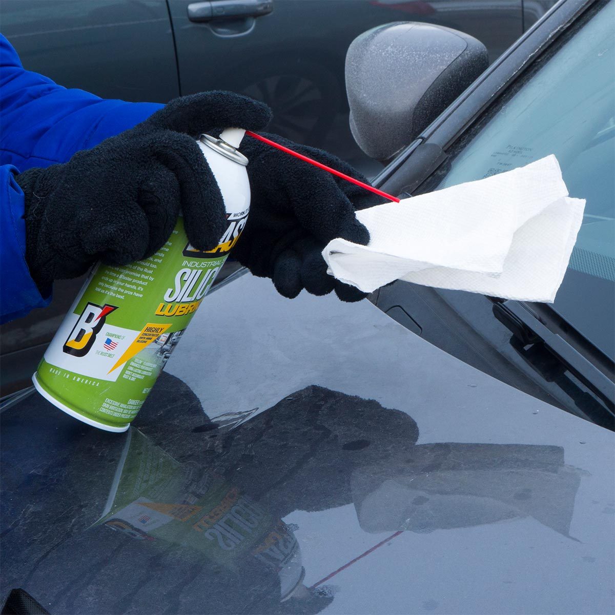

Check you don’t have a piece of trapped ice or grit causing the squeak as this could scratch your windscreen.
Also if you have a high concentration of washer fluid the alcohol can dry out the rubber causing a squeak.
Try cleaning your blades with warm soapy water and after drying wiping the blades with a little rubber lubricant.
The title of that article is a bit misleading, in the article it says spray the moving parts with silicone lubricant, not the blades.
I wouldn't lubricate the actual blades with anything or they tend to slide and judder rather than flip over as they wipe in different directions.
