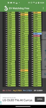

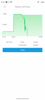

Since October last year when I got my ZS EV and home charger, I have not been able to get a balance charge. I have tried to initiate it after a full charge by unlocking and locking, it starts a charge at 6kw for a short time then stops.
Today after a full charge overnight I tried again, same result. I decided to try the granny charger and it started a balance charge (MG symbol constantly on) and has been that way for nearly 2 hours so far).
To me I'm thinking the sync EV charger doesn't consider the 300w draw of the balance charge enough so it thinks the charge session is over and shuts down.
I have emailed them to see what their view is.
Using EV Watchdog my battery cell voltages look pretty close so hopefully it's not too far out of balance.

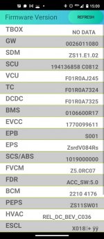

I'm also not on the latest BMS version.

Another factor could be I have the wrong BMS version, current on 0106600R17.
Was going to leave until service in August but will give dealer a call and see if I can get it all updated.
