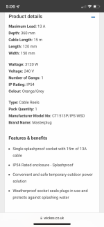

I will be going to the lakes later this month got a lovely cottage for a week with off road parking so I will to using my granny charger for the first time
So thinking ahead I went out today to get a weather proof extension lead found a great deal at wicks 15 meter weather proof lead with storage for £20 the charger plug fits in snugly

Looks good. Just make absolutely sure that the socket that you are plugging into is in good condition to provide 10A for a long period, then check the socket regularly to ensure it doesn't get hot. Unlike the plug on granny the one on your extension has no temperature cutout.
Is it rated for 10a or 13a continuous use and is the a number on the lead saying what size cable are inside?
This cable has a number stamped into it. 3g1.5mm2 3 core and 1.5mm2 fine for 16A, it is my camping hook up lead that I use onto a 13A socket.
