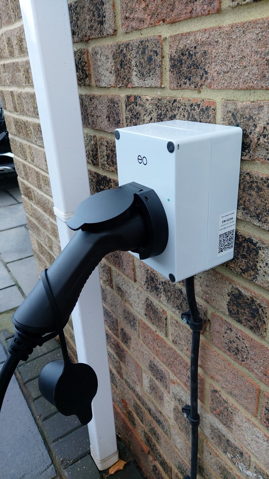

An update on my progress towards getting a home charger.
Quotes after the grant :
EO Mini Pro V2, ( tethered ) - £725.
Zappi which is manufactured locally, ( tethered ) - £750 plus VAT
Apparently the installation for either would be ,"straight forward".
With the EVs predicted mileage (based past annual usage) and the availability of local free public charge points I am struggling to justify the cost of a home charger that would really only be a convenient back up to the Granny charger or free public ones.
Does anyone know where a reasonably priced, reliable home charger can be purchased and installed before I give up.
