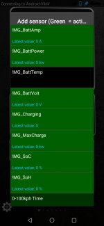

Thanks to Nix here PID's for Torque Pro app (I know it says for ZS but there's a set there for the MG5 as well.)
I can check battery soc/soh/amps/temperature/voltage.. and many other items using Torque Pro. Will hopefully mean not having to turn the car on and off all the time while charging.

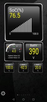

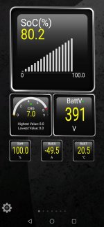

Charging at a 50kw rapid
The CHG meter varies quickly between 1 and 8, not sure what measurement it is but it does show activity.
Images showing charge process and the meters working. The SoC seems to read about 1% lower than the gom. When it gets to 79% the charge rate read via batta drops rapidly to 50%
Works if the car is off or in ready mode
Screenshot_20210816_103921_org.prowl.torque.jpgScreenshot_20210816_104240_org.prowl.torque.jpgScreenshot_20210816_104325_org.prowl.torque.jpg
Based on information in a previous thread - I'm guessing the charging rate is calculated from the figures above?
373 Voltage x 92.9 Amps => 34.65 kW?

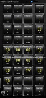

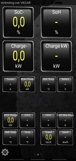

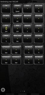

If anyone is interested, here my dash and pid for Torque pro. Pid is based on nix's pid set, on which I added/copied the needed pidnames for ABRP.
Edit: I just saw this thread is for MG5. Sorry for that.
  • MG-ZS-EV_Tp.zip

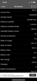

Just if anyone's interested, I'm using the free version of CarScanner on iOS with a bluetooth OBD and it has an inbuilt setting for the MG5 on the app. Managed to pull a SOH (which was 100%!) and various other readings in the All Sensors selection.
