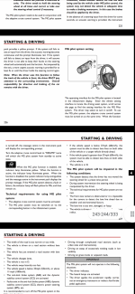

Thanks for the explanation , that all makes sense now ! Only had the car for a few weeks and admit the Adaptive cruise Control System takes getting used to ..ACC can be enabled by pulling the lower stalk towards the driver( the stalk at this point is set in a new position), after which you set a speed by pressing blue SET to the side of stalk.
This will enable front radar based stop & go.
Next, if you toggle the lower stalk twice it enables the lane keeping using the front camera.
The two together form the traffic jam assist. This system is referred to as MG Pilot in the owner's manual.
