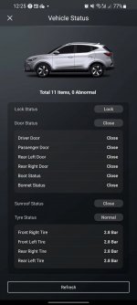

I will try and insert a photo just taken from the App.
I have been checking in on the App today, with regards to tyre pressure reports and I will uploads the pictures that show the slight variations in what is reported.
I believe the ambient temperature is naturally affecting the small fluctuations.
The car has not moved all day.
The time of these snap shots can be seen in the top left hand side of the screen.
I am not at all concerned by this to be honest.
2.8 Bar or 41 Psi if you prefer.
