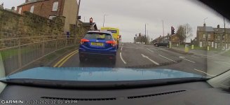

Garmin mini 2 fitted today nice and discreet, nothing to fiddle with just works, no gps but that’s fine only really interested in footage of any incident
It looks pretty neat - have you seen any night time footage yet? What's the quality like?
Only what I saw on the reviews, pretty good fitting at Halford £35 which included the Garmin parking mode cable which they charge £20 separately for so seems a bit of a bargain, not that it was really needed but ha ho. I’ll post a night shot when next out in the ZS. Day time looks pretty good tho.
