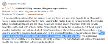

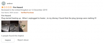

Your electric fire is going to consume the same amount of current as that kettle. That's why the 3kw electric heaters melt sockets, quite frequently. See some examples attached. That's just after looking at the first 3kw heater that appeared on amazon UK.
