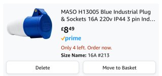

Hello MG EV Community.
I have a 2023 MG4 and I’m looking to supplement my rental property’s power supply in a bid to reduce my crippling bills + have a safe camping power supply solution using existing IP44 plugs and extension cables compatible with electrical hookups at caravan parks etc.
Is it possible for any of you good folk out there to talk through, to this electrical luddite, the ‘in’s and out’s’ of the whole process? My main concern is the ohm rating required for the car to recognise a discharging cable on the latest MG’s?
Any help greatly appreciated…

Fair point, my landlords are very understanding (and live next door!) and the main purpose of the cable would be to introduce occasional power to my garage to run a 2kW heater.
I think it would be useful to explain exactly what, where, when and why you need to use the car's battery to heat the garage. I am in the dark here, a bit.
Are you intending to charge the car at an overnight rate and then heat the garage from the car in place of heating from the mains?
