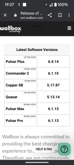

Long story short. What s/w vers are you on and how does it compare to their recommendation?

I am using the latest software that is available.
Any other other thoughts .
Latest is as follows :
