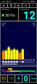

The MG could have some sort of interference or signal blocking properties that weaken the GPS even more. Download a GPS testing tool like GPS Test and see what the strength in like In/Out of the MG. Put the phone in the place it would be when using AA, and plug in the car charger if you have one. This will give a worse case situation.
Ok thx
Just to follow up on using GPS test. Your looking for a SNR in the green area, and an accuracy as close to +-0 meters as possible. A low SNR will mean the GPS is susceptible to dropping out completely, where as low accuracy will mean the car may lag behind. see this screenshot, this is from my cheep Nokia 5.3 with a bad GPS signal
Signal is the same in and out of the MG. I think the problem is with waze
