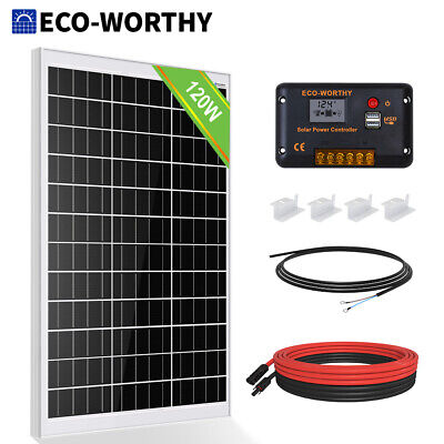

You could use say 500W of panels buy a solar controller inverter and leisure battery and have a bit of 240V power in the man cave for not much outlay maybe run some LED lights off it and charge the power tools.
I do that with a single 100W solar panel kit, leisure battery and a cheapo ebay inverter, total cost less than £250. For example
I'm sure with all the kit you have you can do better than that.
