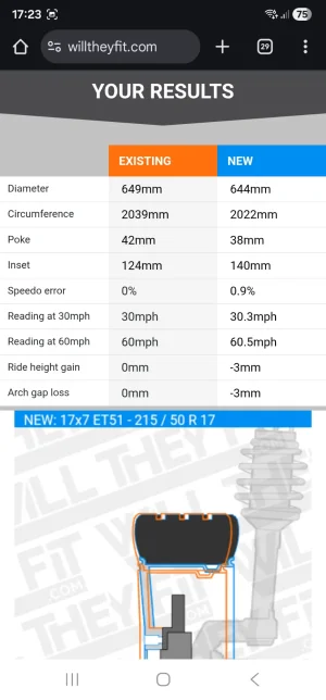

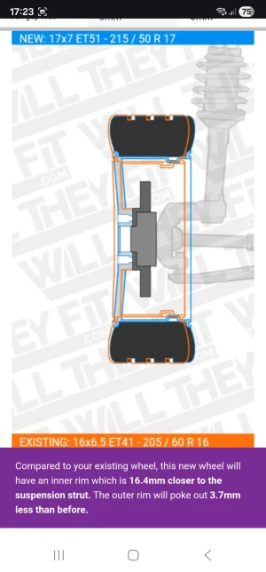

I hope this old thread can still be read... I would like to know if anyone has 16" rims for the MG 4: I would like to make a winter wheels set with 16" rims, but I have doubts about the correct offset. The database of wheel-size.com says that the offset for 6.5Jx16 rims should be 41 (+/- 2) but this sounds strange to me, since the offset of 17" and 18" rims is 51. In some car models the smaller rim also requires a little smaller ET indeed, but a difference of 10 mm seems too much to me. Also for other MG models, the ET for smaller rims varies at muximum of 1-2 mm... Can anyone confirm the correct ET for 16" wheels of MG 4 standard range?

Thank you. The difference between ET 51 and 41 is not so large indeed. I will trust wheel-size.com and will mount the 16'' rims from Audi Q2, which are 6.5Jx16 ET 41.

The 16" measure is in the official user manual as an option and the 6.5Jx16 is the adviced measure. The offset is not specified but I found the 41 value on wheel-measure database. The smaller value is probably just due to a smaller rim size (all the other MG models only mount 17, 18 or 19") to be sure that the brake caliper is not bathed. Thank you
Hi! This is the difference between the original 17'' sizes and the 16'' sizes listed on Wheel-Size. To check more size options, you can use willtheyfit.com
