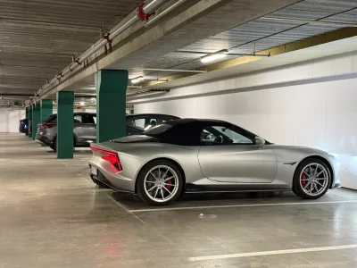

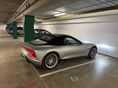

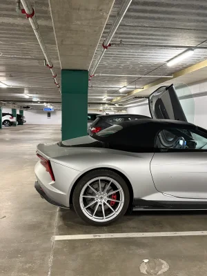

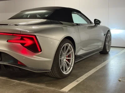

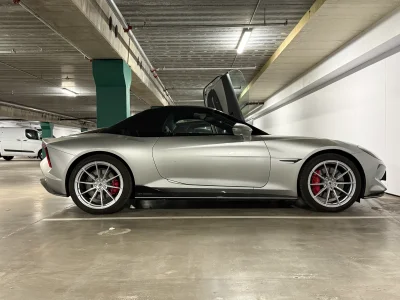

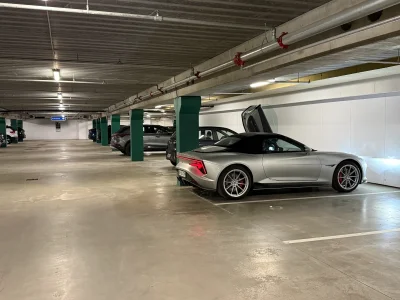

You should check this part of the forum: MG Cyberster Upgrades & Accessories. There's a thread on aftermarket wheels. Just installed these on my GT. They are 9x20 ET 30 front and 10x20 ET35. It's hard to go wider in the front and rear - I considered 9,5 front and 10,5 rear, but was afraid of rubbing and getting to close to the suspension + my wheels are forged (and so much lighter than OEM) and these were the best specs I could get with those wheels (I looked at SO many wheels :-)). Finally they are TüV approved for the Cyberster
