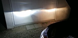

I found the original headlight's very poor, I didn't fell comfortable with that output. So I changed to LED's, and it was really an uplifting experience. See the pictures and you will see.
I also changed reverse, interior and trunk light. And maybe more will come.
LED's for me is both about safety and good looks.
