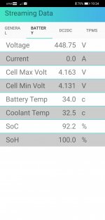

This is one quite a number of us use, Vgate from Amazon. Works well with my phone, as you can see from the data screen shot.

You can get BMS version, cell max and Min voltages etc.I do not leave it permanently connected.

Does this device show correct SOC? I just got it a few days back and after a full charge when the car shows charge completed, it always shows around 92%. However as the battery goes down a bit, it seems to get closer to what is shown by the car at the time of charging.
The maximum soc with the latest BMS 0210622EU1,is 93.1%, which is correct, it is not good for a battery to be charged to 100% and is thus protected (The cars display, when you open a door when charging and being fully charged, will show 100% but the battery is only actually charged to 93% (it's software maximum set point, as indicated using an OBD device). 93% is the start point of the upper buffer and is the reason you get regen even from a fully charged battery as there is 7% available to store electricity. See my post #2 and you can see the readings taken when my car was fully charged and soh 100%. You should get similar readings my car has done 8,500 miles.
The maximum soc with the latest BMS 0210622EU1,is 93.1%, which is correct, it is not good for a battery to be charged to 100% and is thus protected.. This is the start point of the upper buffer and is the reason you get regen even from a fully charged battery. See my post #2 and you can see the readings taken when my car was fully charged and soh 100%. You should get similar readings my car has done 8,500 miles.
Thanks for the response. So that would mean a usable capacity of around 41.5 Kw. Then why is the usable capacity quoted at 42.5? These are my figures from right now as per the app. I wish we could tweak this to show 100% at the top of the buffer to help us understand battery usage.
Probably calculated from the original BMS which has a higher soc. In the real work 1 kWh is negligible temperature has a much greater effect on range.
