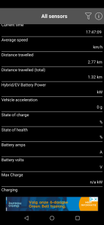

I have connection see some information but the most important things for me not including soh...how long does this take before it is visible?

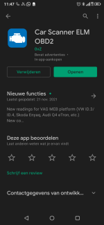

Car scanner
I cannot access at the moment but from memory in 'all sensors' it will be in their somewhere.

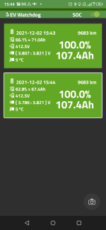

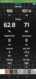

I created a dashboard with the bits I wanted.
