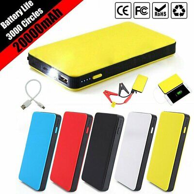

lovemyev....which battery pack do you have
I have just ordered one of these, useful allrounder hopefully. I wouldn't have thought it needs to be too powerful as not turning over a big engine
