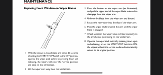

I bought a new MG5 in June 2021.
Normally when I hand wash my cars I lift the wiper arms off the screen, so that I can wash and dry the whole windscreen. When I tried to do this, I realised that the wiper arms foul the edge of the bonnet closest to the windscreen with the risk that the paint on the bonnet could of scratched. Has anyone else experienced this, and any suggestions how to avoid damage (other than not lifting the wipers)?

There is a park mode to allow you to lift them up.
