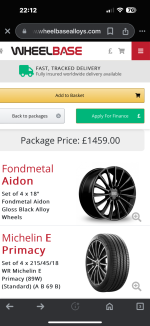

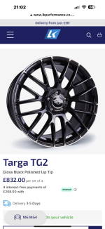

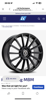

Thankyou for that information bud. MG say they left the x power ride height standard, because during harsh acceleration it “squats” ?. So Im concerned if I put 19” Alloys on with a 40 wall , they will catch/rub if I Gun the car. I notice that ALL the modifications on Job Job seem to be to the base model SE. I agree that the body kits look really good. Love Thailand ?? & its people & food, I’ve travelled it quite extensively & once spent 3 weeks on Kho Phi Phi island prior to the devastating tsunami (The Beach, Leonardo de crappio for others reading this). Please ? Thank your Girlfriend for taking the time to translate ? Below are my favourite 19” alloys for my White/black x power ?

19s with 40s will give you the same rolling diameter of the 18s otherwise you speedo would be way way out ..
30mm drop will do nothing the wheels will sit within the arch as by law wheels and tires must not protrude out from guards flared guards included..
It will squat by default but at worse case it will sit inside the guards if it does...
worse case ( and if available ) you could find stiffer shocks but then your changing the whole dynamics of the car..
The car squats the way it does to force the tyres to the road to gain more traction at acceleration ..
the front motor kinda just picks up the ( to explain in simple form ) slack that 320kw will have forced only though the rear wheels ..
Using 235 40 r19s will be the same width and height using 235 45 r 18s with in a few mm
Now if you were slapping 255s up they will by default sit out side the guards and will rub on the guards ..

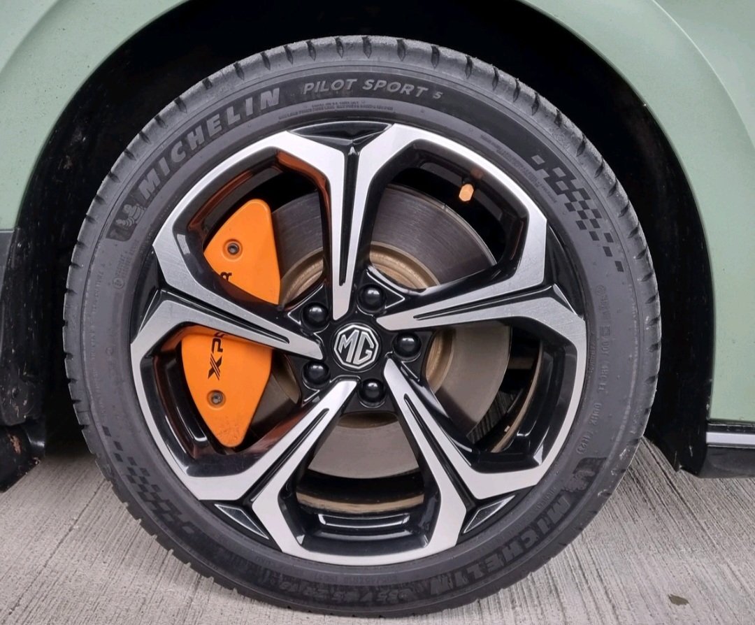

I'm wondering if the rust that starts to show itself after 30 seconds of being stationary is actually deliberate to match the caliper covers.
@Bricktop X PWR I'm impressed with how not-ferrous yours look in this but seeing the matching dust cap makes me think maybe we've all been missing a trick.

It does! Mine did.
I will give them a quick dusting of hammerite over the summer (probably)
And the Ali Express dust caps faded so quickly I've put the black ones back on.
Cheap Chinese Tat.
Wait a minute...............?
I also recently replaced the Front Near Side Mud Flap because that was hanging off.
More C. C. T.

just give them a wire brush and spray them with high temp caliper paint should do the job!!
Ohh and do the pilot sport 5s work nice on the x power??
going to use them at some point was just wondering on your thoughts over the stock turanzas ??
