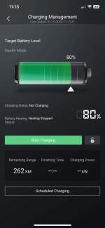

OK Jonknee, good news !! - this is what I found this morning thanks to Pete C
It is a simple process and is probably the best way to charge and get remote heating (twice) without having to go near to or restart the car.
1. I went onto the Ismart app and set the charge limit to 80%
2. Charged the car up 80% from my 7kw home charge and charge finised at 80%.
3. I waited a minute to confirm the charge had definitely stopped (checked no lights in charging door also)

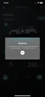

4. Started the remote heating from the app and it successfully started (cable was still plugged in but not charging)
5. Once the pre heat had finished, I started charging again by increasing the set % to 100% in the app.

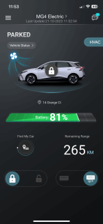

6. Car started charging again and I left if for a few minutes before stopping again at around 81% charge. The photos relate to this stage and state of charge)
7. I waited a minute again to confirm charge had definitely stopped (checked lights in charging door also - see photo below)
8 With the cable still plugged in but not charging I started the remote heating from the app for a second time and again it successfully started (cable was still plugged in but not charging - see photos below).
So using that method you can preheat the car remotely from the app twice without having to disconnect the cable.

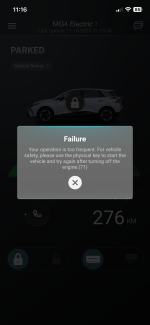

I would advise that you can only preheat twice - after that it comes up with an error (see last photo)
