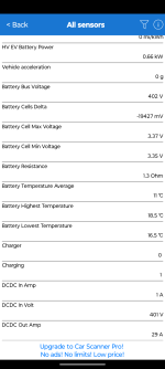

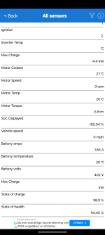

Hi everyone,
Our 22 SR with 8k miles is now showing 94.45 % SOH.
It has only been AC charged, frequently to 100% and not left at a low or high SOC.
Now the weather is warmer I was expecting the GOM estimate to increase, however the best is 193 miles heater off and trip reset.

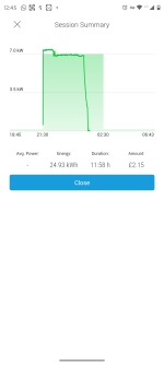

I have never seen it do a balance charge on any of the charge session graphs, it gets to full then stops. That being said I did notice in colder weather it would get to 100% then stay at 1.5kw which I assume was heating as that seems too high for balance. This only happened when it was very cold.

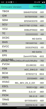

I have attached information on cell voltage etc.
Does anyone know from this if the battery is out of balance?
Could it be the firmware is in need of update?
Can anyone with a SR confirm if the SR actually does balance charge?
Just trying to figure out if something is amiss.
Many thanks in advance.

Sounds more like a badly balanced MK1 how are reading your SOH
How do you get the SOH of battery in ZS EV..?
There are plenty of posts with the free eZS app(Android) with a compatible Bluetooth OBD2 dongle

What did MG say your SOH is on there print out? What was total voltage?
What was the max min voltage of cells?

If you like a good read before bed, then type BMS update in the search field and it should throw up the LONG thread on this subject on the ZS EV Gen 1 model.
We where in the first 1,000 customers for the ZS EV Gen 1 and we did have our up's and down's with software updates etc etc.
Before the car had the software cannon shot at it ( long story ) it was running on the factory software, then it had the BMS update performed.
Therefore I had about 9 - 12 months and about 8,000 miles ( ish ) running on the factory software, then the remaining 10,000+ miles and 12 months on the BMS update.
I spent WAY to long tracking the charging habits of the car after the BMS update.
So, this is what I ( and others ) had observed when it came to charging / balancing from a home wall box.
Pre and post BMS completely changed what I observed when balancing the battery at the end of a full charge cycle.
Pre BMS - When the car reached 100% SOC, the balance would commence.
The time to balance the pack was usually around the 30 minute mark.
Very rarely, it may stretch to 40 - 45 mins absolute tops !.
Post BMS - This pattern completely changed !.
After the update was done, I was told that the car would need to be fully charged and then allowed to balance for a good number of times, in order to correct any imbalance in the pack.
I however, had not suffered from the Buggy software on my car.
But some owners did have this update done, because they where experiencing problem with a sizeable loss in range after their cars became infected with a bug, that entered the car when the likes of the "Comfort 2" update was done etc.
Owners who used rapid chargers, just made the situation worse by D/C charging as higher charging rates, just made matters worse in fact !.
Post BMS - The time to complete a balance from the "get go" increased massively.
The first balance cycle had taken around 8 hours !.
Other owners reported similar times on the first cycle.
But this did quickly reduce in length, after a short time scale of a few weeks, if I remember correctly.
However, it never returned anyway close to the original 30 - 45 minutes on the factory software.
The normal time to balance after the BMS update, was about 3 - 4 hours, when it was only pulling about 500 watts to start with, then it would drop to about 300 watts and then when it hit 175 watts, it would complete very soon after hitting the 175 mark.
It is my understanding, that part of this BMS update, was to increase the buffer space at the head of the pack.
It's been suggested that this is the reason why the balance cycle time had increased post BMS update, which I am inclined to go along with.
So @andymgzs with this in mind, your car installed with the BMS update, taking about 4 hours to balance ( post BMS update ) is similar to our previous Gen 1 ZS EV then.
