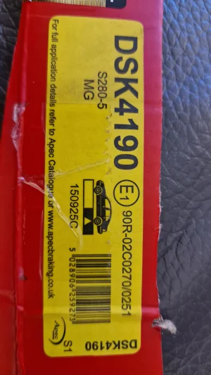

Just had mine serviced and had its first MOT add me to the list of "requires rear disks and pads" £485 please it still passed the MOT and I shall replace the disks myself in the summer. To buy the disks from MG £121.95 (cant find any from anywhere else) but the pads are expensive from MG £147!! wont be paying that that's for sure.

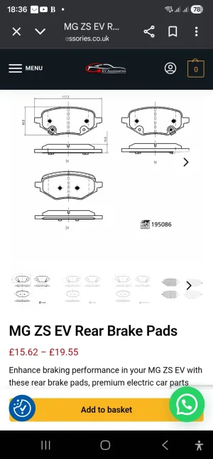

Pads now cheap
