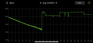

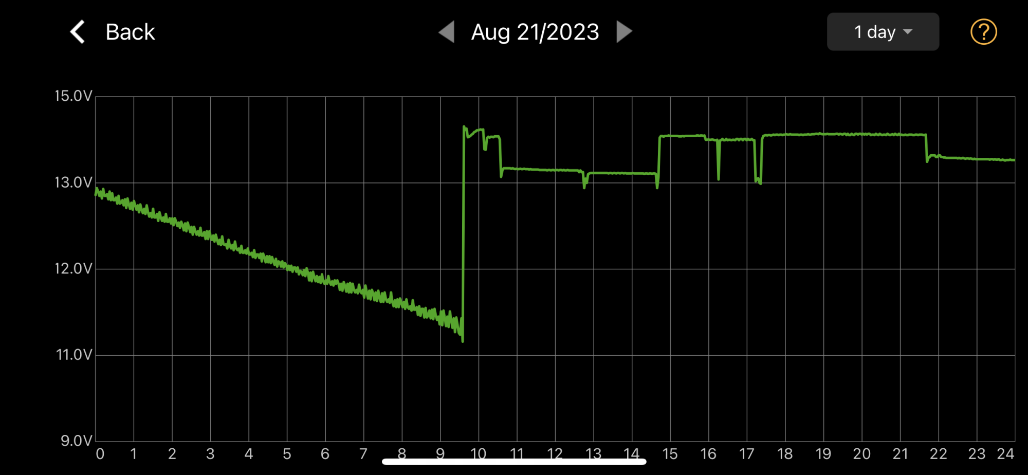

I also noticed this issue when connected to a Zappi mk1 - I have not noticed it at any other time or with our Zappi mk2. The graphic shows the 12v draining after a charge but still connected.
Thanks, that's what I'm now starting to think, it might be the charger [EO Hub 7/22kW, installed 2020]. The 12V battery was so flat I couldn't get it going myself with my SJS Jumpstarter. Called roadside assistance, he measured the voltage as Zero. Once he'd booted it up, all was fine, the traction battery immediately charged it up to 13.6V.
Now I've attached a little BT battery monitor [Century, it draws 0.1mA continuously itself] but because it is BT as soon as I walk out of the basement garage I lose connection. Still the initial data shows that the battery stays stable at 12.6V while the car is Off and not Charging.
It is a worrying thought that leaving the car connected to my Podpoint might allow the 12v battery to discharge. This does not happen when the Podpoint is in charging mode, but it might if the Podpoint is on but disabled, eg with the keyswitch? I wonder how I can test that?
Do you leave that plugged in for hours when not charging? If so, that might be the problem.
Early Nissan Leafs, granted a totally different design, keep a computer running all the time that you have an EVSE plugged in, whether it's charging or not. They too have poor auxiliary battery charging, and there are many reports of the auxiliary battery going flat as a result. So the recommendation for Leafs is not to leave them plugged in (if possible) after they stop charging.
I notice that my Leaf can start charging any time without "waking it up" by opening or closing doors, but my MG ZS EV does have to be woken up. So my MG doesn't seem to be monitoring the plug except for about 5-10 minutes after charging ends. That suggests that the MG shouldn't be draining the auxiliary battery just from being plugged in without charging, but maybe it doesn't work that way.
Worth watching perhaps, especially now that you have a way of monitoring the battery voltage without disturbing the car (opening a door for example wakes up all sorts of computers, changing the auxiliary battery drain profile completely).
